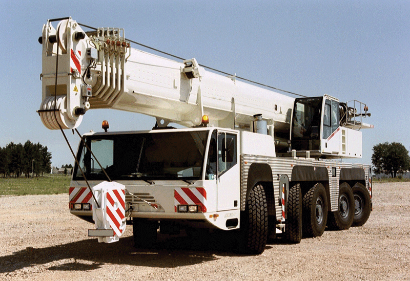

All around the world, large construction projects depend on cranes to move heavy loads around a job site. Whether the crane is stationary, has a crawler drive for mobility, or is truck-mounted, Figure 1, a slew (swing) drive serves as a key element for high productivity and precise positioning — especially considering that boom lengths and hook weights continue to increase.
Figure 1. Terex's AC200 all-terrain telescopic crane typifies powerful cranes used in today's large construction projects. Careful design of the slew drive is a major contributor to the crane's high productivity. Photo courtesy of Terex-Demag.

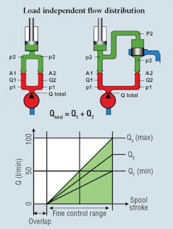

Previous valve designs already satisfied the above demands for a crane slew drive and were systematically orientated towards motor-driven load requirements. A key advantage of the MSC16 slew drive module, Figure 3, over previous designs is pressure compensation downstream of the recirculation duct and the separation and option of a separate control system for meter-in and meter-out functionality. Downstream recirculation pressure compensation is similar to flow sharing. It is based on the principle of load-independent flow distribution (LIFD), Figure 4.
Figure 3. Simplified hydraulic system schematic diagram of MSC16 slew drive module. Click on image for larger view.
Here, the oil flow is parallel-partitioned between the circuit and the slew drive motor via two metering orifices (A1 and A2) with corresponding cross-sectional areas and curves. A load-recording circuit transmits the working pressure P2 to the pressure scales downstream of the recirculation flow so that the pressure after metering orifice A2 (recirculation) is the same as the working pressure. If production tolerances and friction in the pipes are neglected, the pump oil flow is partitioned as follows according to the cross sections of the metering orifices:
Q1 ÷ Q2 = A1 ÷ A2
Figure 4. Load-independent flow control uses two metering orifices (with corresponding cross-sectional areas) to divide fluid flow into parallel paths. Click on image for larger view.
Linear oil flow (corresponding to the spool piston cross-sectional configuration) is beneficial with this switching control system regardless of the pump's meter-in flow, and for the fine control range to remain constant. As described above, no reduction of resolution across the piston spool stroke occurs. Therefore, we can assume that:
