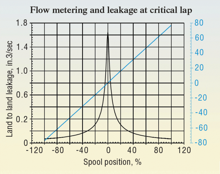

When modeling a proportional or servovalve for subsequent simulation, output data for flow metering and leakage are steady state. As such, they are arranged similar to those that would be collected during testing a real valve, such as an automated data acquisition system. Figure 1 contains the flow metering and land-to-land leakage data over the spool position range of ±100% for the valve model from previous discussions.

The first thing to note in Figure 1 is that the valve is critically lapped. Looking at the flow metering curve, the slope of the flow metering curve does not increase or decrease as it goes through zero. This is an example of a sort of “perfect” flow grinding result. This is, more or less, the aim of the flow grinding technician in a real valve. Such near-perfect performance is not always achievable in a real valve because of the need for practical tolerances and cost constraints. However, it is simple to achieve in simulation, even though finding critical lap is a trial-and-error process.
Figure 1. Flow metering and land-to-land leakage characteristics of the valve as dictated by the input data are represented. This graph contains two of 14 simulation output variables.
The second thing to note is that the peak value of the flow is about 1.84 in.³/sec, whereas the specified input is 2.75 in.³/sec. This discrepancy is caused by unknowns existing at the outset of the simulation. We do not know where the spool will be when the leakage maximizes, so we can only guess at what that might be.
The value of the peak leakage in the input data was set to the value of the two flow functions (hyperbola and straight line) at their point of transition. However, the point of transition is not necessarily the point where the leakage peaks.
The results in Figure 1 depict a critically lapped spool. We do not always know from the actual test data if the valve is critically lapped. Therefore, a trial-and-error process is applied (multiple successive program executions with different values of overlap) until critical lap is achieved in the output. The peak leakage then becomes whatever that degree of overlap delivers.
