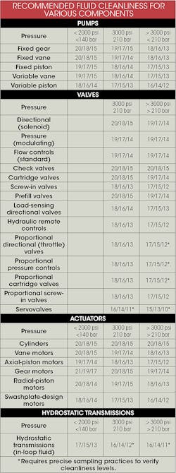

The relationship between fluid contamination and component life is so consistent that hydraulic and filtration OEMs actually publish charts that can be used to predict the consequences of inadequate filtration, as shown in the table. Furthermore, as operating pressures rise and component tolerances tighten in the search for ever-greater efficiency, the potential exists for contaminant particles to cause even more damage to a hydraulic system.

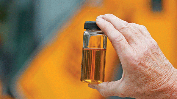

Is this fluid clean? Most contamination particles in hydraulic fluid are too small to be seen by the naked eye, which is why contamination-monitoring instruments are important for maintaining high system reliability.

With today’s filtration technology, an attainable goal for mobile equipment is to reduce fluid contamination to the point whereby it no longer contributes to the failure of any system component during the component’s reasonably expected lifetime. To get there, a target cleanliness level must first be set, one that considers a system’s specific operational needs.
Cleanliness is a very specific quantitative value arrived at using a laboratory particle counting procedure defined by the ISO 4406:99 standard. While it’s too complex to include here, the important output is a cleanliness code consisting of three numbers, e.g. 17/14/12, that represent the number of particles of a specific size found in the oil sample.
The aforementioned contamination/component failure charts are based on cleanliness levels applied to the most contamination-sensitive system components. Fluid-power professionals should use these guidelines to help define target cleanliness levels for particular hydraulic systems.
