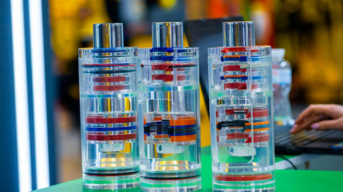

When choosing a seal for use with a hydraulic cylinder, several factors including fluid type, pressures, temperatures and duty cycles must be taken into account.
To help this decision-making process, our top piece in today’s newsletter offers a practical guide examining the elastomer materials commonly used for hydraulic cylinder seals. It reviews the differences between the material types, the hydraulic fluids they best match with as well as operating conditions for which each is best suited.
As author Xing Hong from WRKR Seal explains in the piece, nitrile butadiene rubber, or NBR, is usually the default material for seals used in hydraulic systems because it offers excellent resistance to petroleum-based hydraulic fluids along with good mechanical properties, low compression set, and a favorable cost profile. However, it has no resistance to phosphate-ester fluids, poor resistance to polyol-ester biodegradable fluids, and degrades with prolonged exposure above 120 C.
