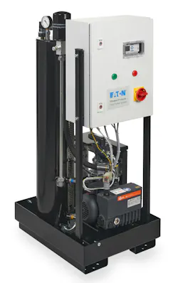

Eaton’s Filtration Division has added a compact option to its line of PLC-controlled offline fluid purification systems, the IFPM 10.
Like other models in the series, the IFPM 10 is designed to remove free, emulsified and dissolved water, free and dissolved gases, as well as particulate contamination from hydraulic and lubrication oils.
But with its compact size, the unit can now be used in severely space-constrained environments, including those where use of fluid purification technology was limited due to space constraints. These include power plants and energy generation facilities, steel production and processing plants, the oil and gas industry, as well as mobile working machines such as tunnel boring machines noted Eaton in its press release announcing the launch of the IFPM 10.
The IFPM 10 uses the same vacuum evaporation technology as other models in Eaton’s purifier series as well. Eaton explained that this technology works by drawing contaminated fluid into the system under vacuum and distributing it over a dispersion material inside the vacuum chamber, increasing the evaporation surface area.
At the same time, ambient air flows counter-current to the oil and is drawn in through a breather filter, which helps manage moisture and releases it to the atmosphere via a vacuum pump. The dehydrated fluid is then pumped back into the reservoir through an integrated replaceable spin-on filter that is designed to retain particulate contamination.
The IFPM 10 features a flow rate of about 2.6 gal/min (10 l/min), and is available in mobile as well as stationary versions to suit specific application needs.

  • Continuous measurement of fluid temperature and water saturation
  • User-friendly interface allows for simple and convenient operation via pushbuttons located directly on the unit’s control cabinet
  • PLC control enables fully automatic offline operation.
